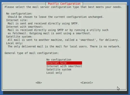

I have a desktop install of ubuntu, not server. But I am running a localhost LAMP stack for development. Is there a simple mail server I can install so that PHP's sendmail works?
Ideally it will have few options and minimal configuration, and preferably a GUI rather than CL interface.
EDIT to add - do I use the Local Only configuration to test php mail()? enter image description here

Just postfix is needed.
For setup, just use the defaults. Internet site. When you get to it, there's a section for setting which computers are allowed to relay mail through the server. The default is 127.0.0.1 (worded slightly more verbosely) and this is good. This means even if another computer can connect to postfix, postfix wont allow it to send mail anwhere but to the destinations postfix accepts as "local" domains.

You do not need a mail server to send email, only to receive email. For sending email (using sendmail) select the Internet with smarthost option.
