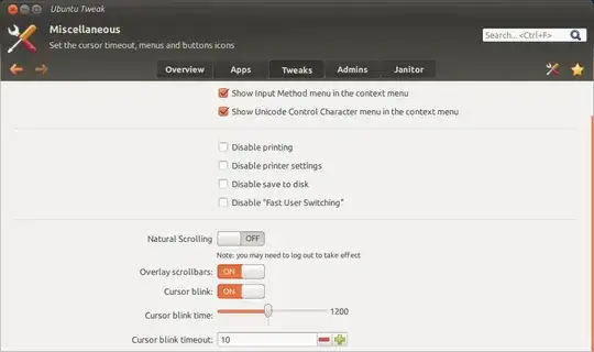

For tweaking ubuntu install: ... ubuntu-tweak
sudo add-apt-repository ppa:tualatrix/ppa
sudo apt-get update
sudo apt-get install ubuntu-tweak
In the dash search for "ubuntu tweak"
Once open, click Tweaks tab, then Miscellaneous, then toggle Overlay scrollbars off
