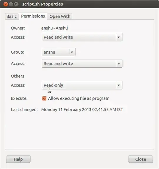

Both the desktop entry and the shell script should have executable permissions. Do:
$ chmod +x path_to_shortcut/shortcut.desktop
$ chmod +x path_to_script/test.sh
Another way to change permissions for a script is to right click it, go to Properties > Premissions and check Allow executing file as program.
Permissions
