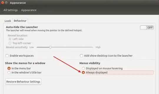

In addition to the gsettings menu option introduced in 15.04, this has been added to Settings - Appearance:
15.04, 15.10 & 14.04
15.04 now has the ability to toggle the global menu as well as the local integrated menus (Via System Settings - Appearance - Behaviour tab) to be permanently on or off.
If you are running a fully up-to-date version of 14.04, this same ability has been backported.
To switch on permanently:
gsettings set com.canonical.Unity always-show-menus true
To switch off i.e. to autohide:
gsettings set com.canonical.Unity always-show-menus false
