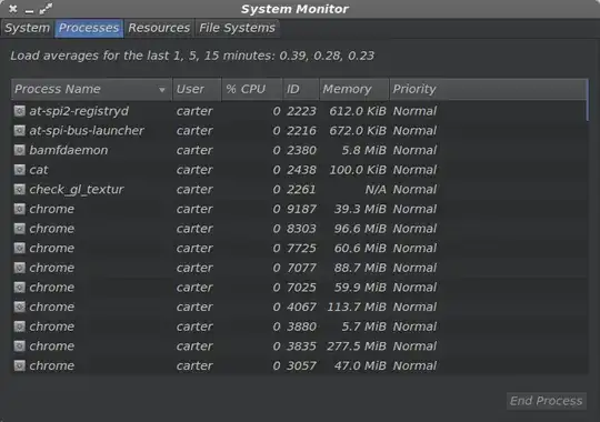

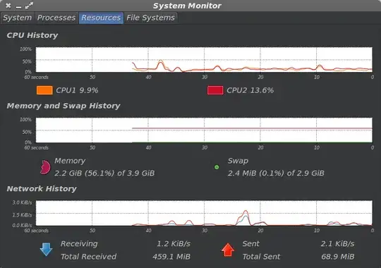

As you have not specified your Desktop environment I will assume you are using Using Ubuntu
For a graphical way to check your cpu usage, search your system for an application called System monitor.
The Resources tab will show activity of each core
Whilst the Processes tab will show cpu usage for individual programmes.

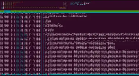

htop tool provides graphs for cpu core(s) usage
install htop via terminal:
apt-get install htop
run htop via terminal:
htop
htop in the ubuntu terminal looks like this
