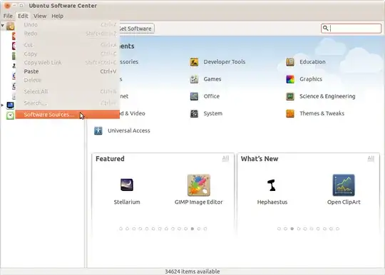

In the Software Center (Applications -> Ubuntu Software Center) navigate to Edit -> Software Sources...
software sources

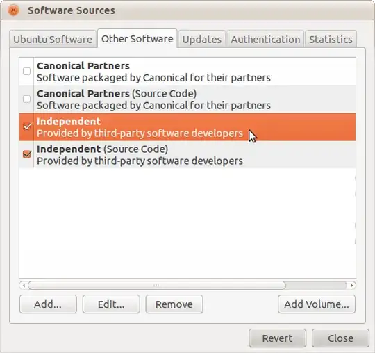

From there navigate to the Other Software tab and ensure the Independent sources are selected
independent
Press close and allow the sources to reload.

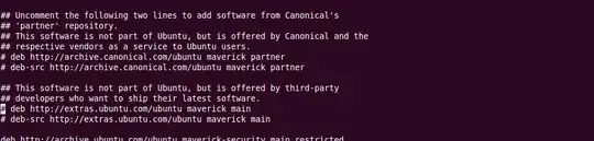

Locate the lines which say
deb
Remove the hash (#) tag from those lines. If the hashes are not present then that source is already enabled. If those lines aren't there at all you will need to add them to the bottom of the file:
deb http://extras.ubuntu.com/ubuntu precise main
deb-src http://extras.ubuntu.com/ubuntu precise main
