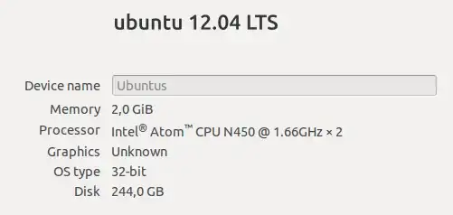

I’ve had this problem after 11.04, I mean in either 11.10, 12.04 and 12.10, and saw in various netbooks and laptops. I guessed it should be related to unknown graphics driver; because I had a known driver in 11.04 and no problem, but an unknown one in all computers with this problem:
Unknown graphics

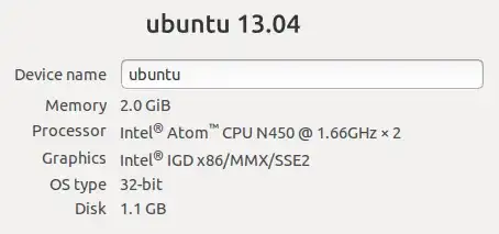

So I just tried 13.04 via USB and faced the same problem although the graphics was known:
Known graphics
