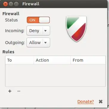

It does not matter if you enable or disable the firewall in the terminal, since the *gufw app needs administrative rights it will always open like this:
after you unlock the app with your password then you will see that it is actually active:
This is because the system does not know if the person opening gufw is the same person that enabled the Firewall in the terminal (You might have just walked out of the room to go to the bathroom and a hacker just climbed through the window, ran to your computer and tried to open gufw while you were away). So this is why it asks again, just to make sure.

When you start gufw it is shown as off, but then when you unlock it, you'll see that it is on.
