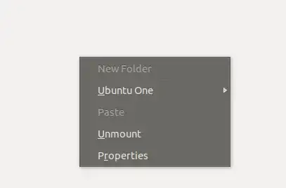

I have a 1 TB external hard drive and I can't write anything on there. I have some movies on there and I can watch them perfectly fine but I can copy new files to there, it's just grayed out.

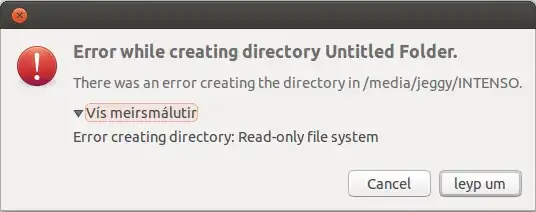

This is what i get and after i followed the instructions by Luis Alvarado
and now "New Folder" isn't grayed out but i get this when trying to create one:
enter image description here Leyp um = Skip
And the lampp folder is a folder i thought i lost yesterday, so if there's anyway i can get that folder back, it would be very great as there is some PHP codes i have been working on and maybe my last chance of ever getting them back.

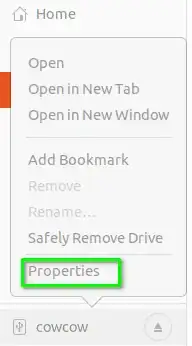

In my case, it was due to my current user account not being given write permission for the external HDD. My external HDD is formatted as NTFS. Remounting the drive with write permissions did the trick. Refer to this for steps.
To figure out your drive's file path and name, run mount. An example of what to look for in the output is:
/dev/sda1 on /media/<<your-account-name>>/<<external-drive-name>>

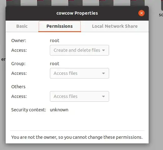

Once you have completed all steps, check the HDD's Properties -> Permissions. Owner should have "Create and Delete" acces, while root and others will have "Access files" access:
Where to find drive properties:
where to find drive properties
New drive permissions:
new drive permissions
