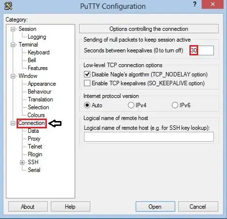

If you go to your putty settings -> Connection and set the value of "Seconds between keepalives" to 30 seconds this should solve your problem.
PuTTY Configuration

Go to PuTTy options --> Connection
  1. Change the default value for "Seconds between keepalives(0s to turn off)"
    • change it from 0s to 60s (1 minutes) --This varies...reduce if 1 minutes doesn't help
  2. Check the "Enable TCP_keepalives (SO_KEEPALIVE option)" check box.
  3. Finally save setting for session

The 30 seconds timeout never worked for me so I tried playing with a bit and came up with a solution by increasing the timeout to 240(4 mins), now it works like a charm
