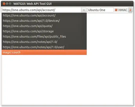

It is possible to see and modify the Ubuntu One CouchDB, but not via Futon. All you need to do is do OAuth-authenticated (but not HMAC-signed OAuth) REST requests to the right URL, using your Ubuntu One-specific Ubuntu SSO token.
One easy(ish) way of seeing the Ubuntu One CouchDB is using a little tool I wrote, which I called watgui because I'm really bad at names. It only does GET requests for now.
First, you use the tool to work out the “magic CouchDB URL”: watgui magic url thing
Then, you turn off HMAC signing, and you can use the URL to get access to the databases. For example, here's me looking at my notes database:
watgui looking at my notes couchdb
