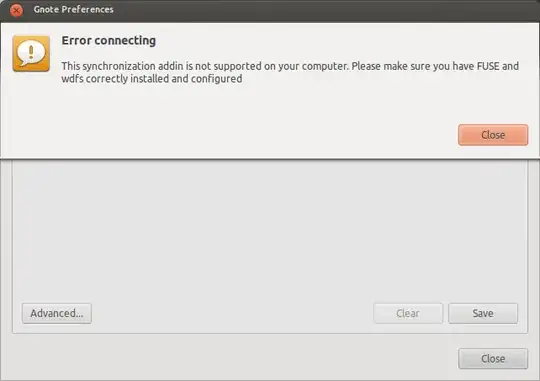

If I want to sync my notes with WebDAV server, I get the following error messages in Gnote and Tomboy:
This synchronization addin is not supported on your computer. Please make sure you have FUSE and wdfs correctly installed and configured
How can I set up FUSE and wdfs?
Gnote WebDAV connecting error Tomboy WebDAV connecting error
