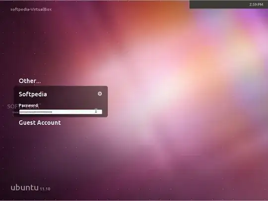

Ah, this happened to me, and the solution is easy. First, log off. (Or go to the login screen.)enter image description here
enter image description here Now, as shown, click the Ubuntu Logo.
It will open this. Click 'Ubuntu' (Not Ubuntu 2D.) Then sign in as normal. Note: This will always be the default setting. To change it, use these steps again.
Sorry about the formatting. It's quite hard.
Oh, and the options on the 3rd image you might not have.(E.g. GNOME)Unless you installed them.

To log into the Unity-3D interface you will need to log out and log in again. This time click the icon next to the username and from the two options "Unity 2D" and "Unity" select the second one. Hopefully it will help you, if you have Unity-3D on your system.

If you want the Unity desktop log out then at the login screen click the circular icon next to you name and the password box. Select "Unity" as your desktop then login again.
