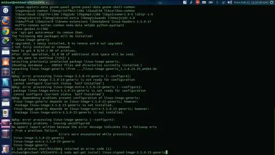

enter image description hereenter image description hereAnytime I install something or update Ubuntu, I notice this during the ending process in the terminal:
linux-image-3.5.0-23-generic
linux-image-extra-3.5.0-23-generic
linux-image-generic
E: Sub-process /usr/bin/dpkg returned an error code (1).
Is there a fix for this?
Purging those kernel packages and their configuration files, then re-installing them may solve the issue. In terminal:
sudo apt-get purge linux-image-3.5.0-23-generic linux-image-extra-3.5.0-23-generic linux-image-generic && sudo apt-get install linux-image-3.5.0-23-generic linux-image-extra-3.5.0-23-generic linux-image-generic

I was having a similar problem on a VirtualBox and the problem was I didn't have PAE enabled.
