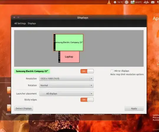

The solution is to disable TwinView and use a driver which has XRandR support. This is present in the Nvidia driver since version 302. Use Ubuntu's Displays panel to configure the displays through XRandR (in 12.04 and later, click on the power button in the top right and select "Displays...").
At settings in Displays you select the red screen which is TwinView and change on buttom to off at the box next to your laptop screen. Then Apply a box will appear which you will need to press keep settings. Now you shut see it only on the tv and your TwinView shut come black. Displays Settings
