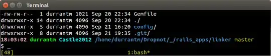

My preferred solution to the issue of long lines overlap in bash PS1 is to have a \n at the end of PS1 prompt line(s).
e.g.
If you want all my other stuff - time, user, host, directory and git branch(!) you can use this (mac or linux):
https://unix.stackexchange.com/a/124012/10043
