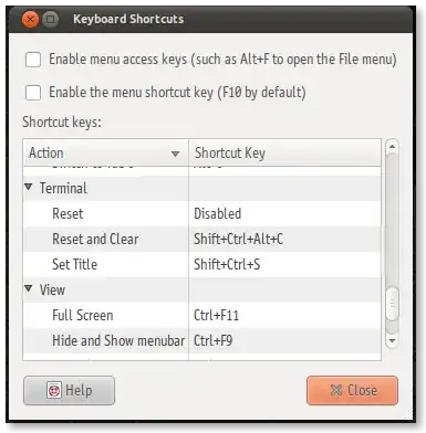

You can also assign a shortcut in gnome-terminal by going to Edit → Keyboard Shortcuts. I useShift+Ctrl+Alt+C.
reset and clear shortcut
