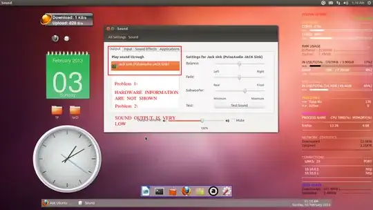

After restarting pc I can see both Jack and Pulseaudio working Ok. But here is another problem, the sound output form the speakers are very low, cpu spikes have increased quite a bit, Hardware devices are not shown. Sound control shows 5:1 sound system where I only have 2:1 sound system.
I need a way to switch between Pulseaudio and Jack. Im not a professional music maker. I need Jackd only when Im using Ardour or any other app that needs Jack. You must be thinking Pulseaudio will be automatically disabled when starting Jack. But that is not the case for me. Previously I have faced erros trying so

Now my question is how can I switch between Pulse and Jack safely ? Is there any app to do so ?
Here's a screenshot -
