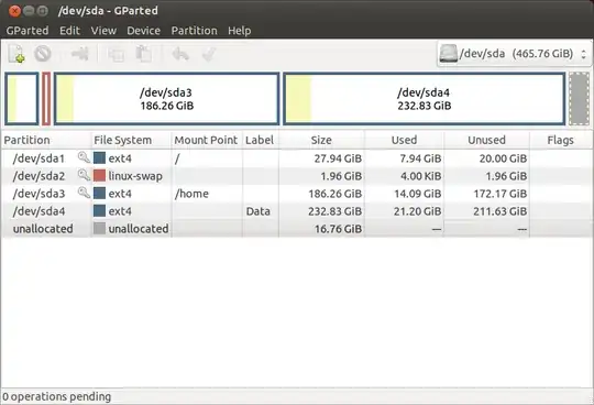

  1. Boot up with live Ubuntu CD or bootable Ubuntu usb
  2. Choose 'Something else' installation type
  3. Delete the partition in which to install Ubuntu
  4. Create Ext4 partition and separate swap space greater than equal to your physical RAM
  5. Select the mount point for Ext4 partition to be '/'
  6. Perform install.
Note: Creating a separate partition for home folder is a good idea. You can refer to this article for that.
Also, You can refer to this article for step-by-step installation of Ubuntu.
The partition can be some like this. If you wanna reinstall, you can format root partition only and your home partition still safe.
