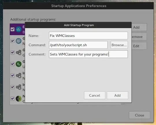

And finally, set the .sh we created to run every time the OS starts up: Screenshot
Hope my answer is helpful to anyone browsing this question.
