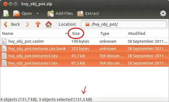

When you open a ZIP-file with the archive manager, it tells you the size of the contained files.
If you want to know how much all or some contained files are, just mark them (to mark all files: CTRL+A) and take a look at the bar on the bottom.enter image description here
