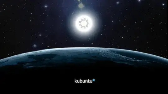

  1. Download the Earth-sunrise theme.
  2. Unpack it

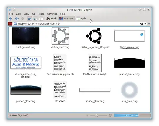

  3. Copy the Earth-sunrise folder to /lib/plymouth/themes/Earth-sunrise. Note ! Ubuntu 16.04 and later are using /usr/share/plymouth/themes/. More: Unable to use a custom splash screen in Ubuntu 16.04LTS
  5. Add the Earth-sunrise theme to the Plymouth 'alternatives'.

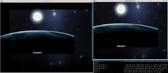

  8. Test the theme (install plymouth-x11 Install plymouth-x11)
    • Konsole #1
      sudo plymouthd --debug --tty=`tty` --no-daemon
    • Konsole #2
      sudo plymouth show-splash
    There are two (malformed) test konsoles.
    Stopping the test with the command:
    sudo plymouth --quit
  9. Reboot
