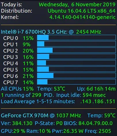

conky is the solution.

As mentioned conky is great at showing uptime:
However as this script illustrates Linux uptime is misleading because it includes the time the system was suspended:

Linux uptime 576,965 seconds (6 Days 16 Hours 16 Minutes 5 Seconds)
13 Suspends 366,910 seconds (4 Days 5 Hours 55 Minutes 10 Seconds)
Real uptime 210,055 seconds (2 Days 10 Hours 20 Minutes 55 Seconds)
