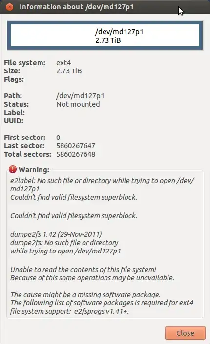

Today I plugged in another hard drive and unplugged my raid drives to ensure when I wiped the drive, I would not accidentally pick the wrong drives.
Now that I have re-plugged in my drives, the software raid 1 array is no longer being mounted/recognized/found. Using disk utility, I could see that the drives are /dev/sda and /dev/sdb so I tried running sudo mdadm -A /dev/sda /dev/sdb Unfortunately I keep getting an error message stating mdadm: device /dev/sda exists but is not an md array

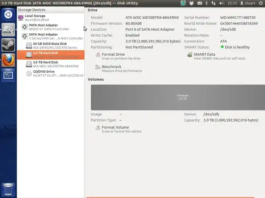

Smart tests on drives both came back 'healthy' however I cannot boot the machine with the drives plugged in when the machine is in AHCI mode (I dont know if this matters but these are 3tb WD reds). I hope this means the drives are fine as they were quite a bit to buy and brand new. Disk utility shows a massive grey 'unknown' shown below:
Image of disk utility showing healthy drives

I have tried putting the drives in another machine. I had the same issue where the machine would not get past the bios screen, but this one would constantly reboot itself. The only way to get the machine to boot would be to unplug the drives. I tried using different sata cables as well with no help. I did once manage to get it to discover the drive but again mdadm --examine revealed no block. Does this suggest my disks themselves are #@@#$#@ even though the short smart tests stated they were 'healthy'?
It appears the drives are truly beyond rescue. I cant even format the volumes in disk utility. Gparted wont see the drives to put a partition table on. I cant even issue a secure erase command to fully reset the drives. It was definitely a software raid that I had set up after discvering that the hardware raid I had initially tried was actually 'fake' raid and slower than software raid.
Thank you for all your efforts to trying to help me. I guess the 'answer' is there is nothing you can do if you somehow manage to kill both your drives simultaneously.
I retried SMART tests (this time in command line rather than disk utility) and the drives do respond successfully 'without error'. However, I am unable to format the drives (using disk utility) or have them recognized by Gparted in that machine or another. I am also unable to run hdparm secure erase or security-set-password commands on the drives. Perhaps I need to dd /dev/null the entire drives? How on earth are they still responding to SMART but two computers are unable to do anything with them? I am running long smart tests on both drives now and will post results in 255 minutes (that's how long it said it was going to take).

It said completed without error. Does that mean the drive should be fine or just that the test was able to complete? Should I start a new question as I'm more concerned about getting the use of the drives back rather than the data/raid array at this point...
Well today I was looking through my filesystem to see if there was any data to keep before setting up centOS instead. I noticed a folder called dmraid.sil in my home folder. I am guessing this is from when I had initially set up the raid array with the fake raid controller? I had made sure to remove the device (quite some time ago way before this problem) and just before using mdadm to create 'software raid'. Is there any way I have missed a trick somewhere and this was somehow running 'fake' raid without the device and that is what this dmraid.sil folder is all about? So confused. There are files in there like sda.size sda_0.dat sda_0.offset etc. Any advice on what this folder represents would be helpful.
Turns out the drives were locked! I unlocked them easily enough with hdparm command. This is probably what caused all the Input Output errors. Unfortunately I now have this problem:
I have managed to mount the md device. Is it possible to unplug one drive, format it to a normal drive and copy the data to that? Ive had enough 'fun' with raid and am going to go down an automated backups route with rsync I think. I want to ask before I do anything that may cause data integrity issues.

The problem was that the drives became 'locked' at some point. This explains:
  • The Input/Output errors I was recieving for all commands.
  • The inability to format the drives or see them with gparted.
  • The inability to boot with the disks in. (would have been helpful if the terminal didn't output this as SMART status BAD)
  • The fact that I would get I/O errors on multiple computers showing it wasn't the cables/bus.
Once unlocked with a simple hdparm command sudo hdparm --user-master u --security-unlock p /dev/sdb(c) and a reboot, my mdxxx device became visible in gparted. I was then able to just sudo mount it to a folder and see all my data! I have no idea what caused the drives to 'lock down'. I am also missing the e2label it seems. I have no idea what this is. Perhaps someone can provide a better answer which explains:
  • how the drives may have become locked in the first place (unplugging the drives while system is up/running/live?)
  • whether this is not an mdadm array? or if it is why the configuration file didn't seem to show this?
