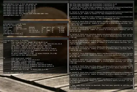

If that image is difficult to read, http://i47.tinypic.com/2r5f22u.png
http://i46.tinypic.com/1zw2rgj.png
http://i48.tinypic.com/2ccml8j.png
http://i49.tinypic.com/j7yxw9.png

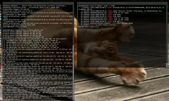

EDIT 2:
http://i47.tinypic.com/qx1mvc.png
