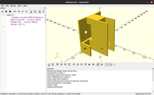

As of version 2019.01, if you do from the command line:
openscad file.stdl
it automatically opens the GUI with the right command to view the file e.g.:
import("/home/ciro/git/OSP/Hardware/CAD Files/P1 - X-Axis Motor Holder/P1 - X-Axis Motor Holder.STL");
Then you can click Design > Render, and it gives for this sample file:
