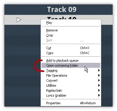

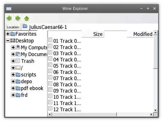

When browsing directories in a Windows program installed in Wine - like when opening a folder in Foobar2000 - Wine always opens the Wine explorer:
Open containing folder option in Foobar2000
The wine file manager
Is it possible to set Wine to open an Ubuntu file manager (e.g Nautilus) instead?

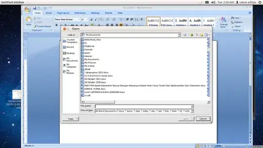

i think no. even i have use crossover with enabled "use native browser by default" it still use it's own file browser when i tried to open file from ms. word
wine file manager
