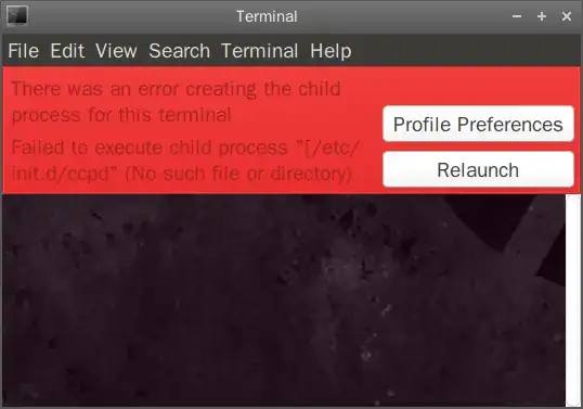

What to do - according to that answer? Creating a script like this
#!/bin/bash
gnome-terminal -e [/etc/init.d/ccpd status]
gives error
How to modify the script to make it work?
