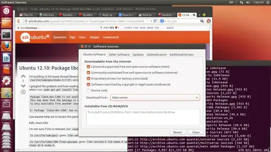

This may not be the proper solution but it will download the package for you.
Type "software sources" in the dash, and change your server to "Main server". This is because some (one of which may be yours) do not maintain the package on their servers. Refer to the image below showing the source changed to "Main server". Then do a sudo apt-get update and then sudo apt-get install libc6-dev-i386. Repeating, this is not the proper solution, but will probably download the package for you.
