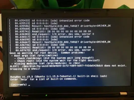

The system boots fine if I selected integrated (or Optimus) graphics in the BIOS, however if I choose Discrete graphics, I'm unable to boot. It appears, weirdly, that when discrete graphics are enabled, Linux is unable to access my hard drive. Here's a screenshot:
Photo of Nvidia problem
Unfortunately, while it appears to dropped to BusyBox, the system is totally unresponsive at that stage and must be rebooted.
The problem persists regardless of whether I've installed Nvidia's drivers, the Open Source Nouveau driver, or both. This is the Nvidia chipset, and the Intel chipset:
00:02.0 VGA compatible controller: Intel Corporation 2nd Generation Core Processor Family Integrated Graphics Controller (rev 09)
01:00.0 VGA compatible controller: NVIDIA Corporation GF119 [Quadro NVS 4200M] (rev a1)
