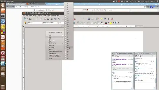

I upgraded my KDE desktop and suddenly it overrode many parts of unity user interface such as menus, icons, and specifically (in this question) lightDM login screen.
here is a screenshot of menus: enter image description here
how should i fix this?
