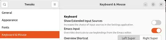

  1. Install gnome-tweak-tool: sudo apt-get install gnome-tweak-tool
  2. Open it: gnome-tweak-tool
  3. Go to Keyboard & Mouse and toggle the Emacs Input option.
Screenshot of the Tweaks window showing the "Emacs Input" toggle inside the "Keyboard & Mouse" section.

gnome-tweak-tool has been replaced with gnome-tweaks:
  1. Install gnome-tweaks: sudo apt-get install gnome-tweaks.
  2. Open it: gnome-tweaks.
  3. Go to Keyboard & Mouse and switch Emacs Input on.
