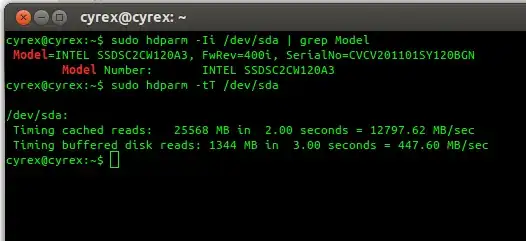

In relation to the SSD, I also have an Intel 520 Series SSD Drive. Mine is the 120GB one. I ran the test as you mentioned and this is the result:
Although this is a test using 13.04, 2 weeks ago I was using it on 12.04 and it gave almost the same result (About ~40 MB less on the buffered disk reads but still high enough)
The only thing left here would be the motherboard. In my case I have the Intel DZ68DB with the latest firmware update. If I were to help in any way, I would first recommend:
