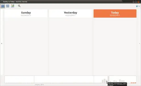

I am running ubuntu 10.10, and installed Gnome Activity Journal. However it does not show any recently used files. I have attached a screenshot below.
Please note that gnome activity journal has been installed on the system for quite some time. So it is not that I recently installed and it still has to slowly gather data. Also the zeitgeist-daemon is running in the background.

Update 2: I checked the spikes in the month of december. But they were nothing. After proceeding to that month, the spike just went back to nothing just like the rest.

Update 5: I no longer get the error posted in update 4. Gnome Activity journal opens but with the same problem as shown in the screenshot. The output of the terminal is

Update 7: This is the most recent screenshot I've inserted below, where it shows 8 items for one or two days. However when I click on that day, GAJ does not show any recently used files. enter image description here
