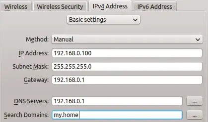

  • Configure the PCs in your network to use my.home as the local search domain. This can be done via DHCP automatically, or if using static addresses via the /etc/network/interfaces file or in Network Manager:
  • Now both simple name resolving (ping hostname) as well as full name (ping hostname.my.home) should work.
