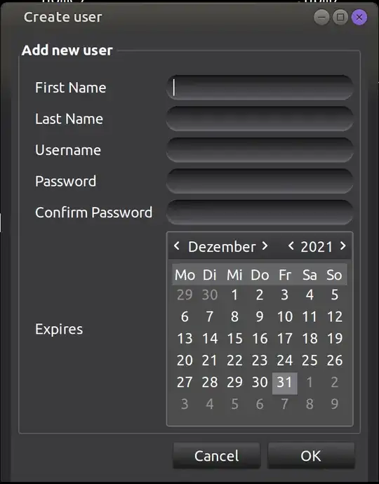

Here is a very nice example, how to create a zenity dialog with multiple inputs.
Different UI types (Checkbox, Date, Colorpicker, etc) are documented here.
and as far as I can tell: zenity is installed out of the Box in Ubuntu 20.04 and larger.
