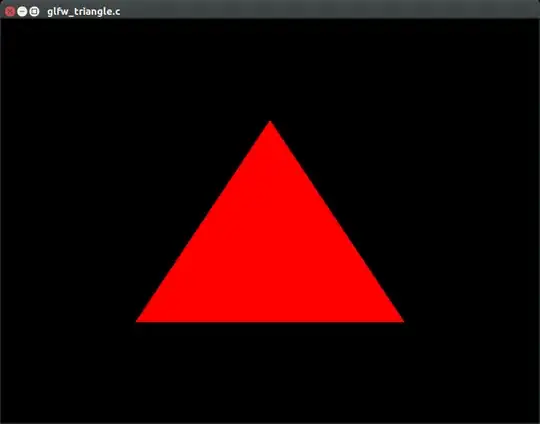

GLFW, Mesa, Ubuntu 16.04 AMD64
I haven't tried it inside of Virtual Box, but this should work regardless since Mesa has a software implementation.
sudo apt-get install libglfw3-dev libgles2-mesa-dev
gcc glfw_triangle.c -lGLESv2 -lglfw
Output:
Source:

The key line lines of code are:
#define GLFW_INCLUDE_ES2
#include <GLFW/glfw3.h>
GLFW_INCLUDE_ES2 is documented at: http://www.glfw.org/docs/latest/build_guide.html#build_macros and a quick look at the source shows that it forwards to GLES:
 #elif defined(GLFW_INCLUDE_ES2)
  #include <GLES2/gl2.h>
  #if defined(GLFW_INCLUDE_GLEXT)
   #include <GLES2/gl2ext.h>
  #endif
This source seems to be is in the common subset of GLES and OpenGL (like much of GLES), and also compiles with -lGL if we remove the #define GLFW_INCLUDE_ES2.
If we add things which are not in GLES like immediate rendering glBegin, link fails as expected.
See also: https://stackoverflow.com/questions/3809236/how-to-develop-opengl-es-gles-2-0-applications-on-linux/39356268#39356268
Credits: genpfult made the code much more correct.

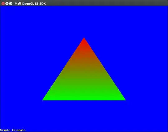

ARM Mali OpenGL ES SDK
Contains several interesting open source examples + windowing system boilerplate (X11 + EGL).
The build system supports easy cross compilation for ARM / Mali SoCs, but I haven't tested that yet.
The key component included seems to be the "OpenGL ES Emulator" http://malideveloper.arm.com/resources/tools/opengl-es-emulator/ which "maps OpenGL ES 3.2 API calls to the OpenGL API". But that does not ship with source, only precompiled.
Uses a custom enterprisey EULA that appears to be permissive, but yeah, ask your lawyer.
Tested on SDK v2.4.4.
