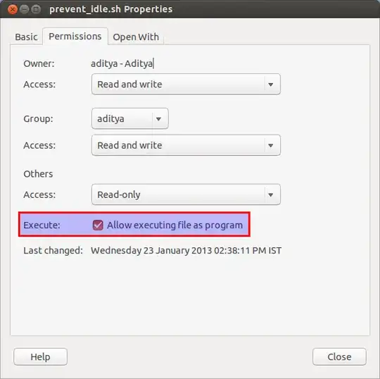

  3. Make this script executable:
    Right-click on the file you just saved >> Select Properties >> In the Permission tab, put the Check mark on Execute.
    make the script executable

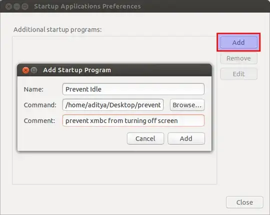

  4. Execute this script automatically on every startup:
    We can do this with the help of Startup Applications. Open your Dash by pressing Enter and query for Startup Applications >> In Startup Applications Window, click on Add >> Then, in the dialog that pops up, fill the information:
    Name: optional, whatever you want to name this.
    Command: path to the file where you saved it.
    Comment: optional, if you wish to add some.
    startup applications preferences

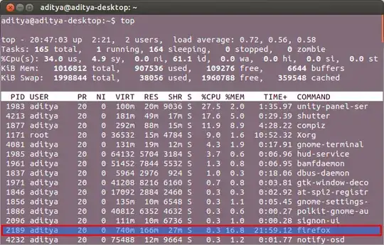

  • With Terminal:
    We can run top to list all the running processes. The last column called Command gives us the name of the Process (however it is limited to first 15 characters).
    Terminal <code>top</code> command
Here we can see that Firefox is just named as firefox. So, if we want this behavior when Firefox is running; we would replace xbmc.bin in the script with firefox and everything else would work just fine.

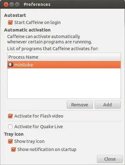

A very simple solution is caffeine. Caffeine is a 'status bar application able to temporarily prevent the activation of both the screensaver and the "sleep" powersaving mode.'
Enabling it is as easy as clicking the status bar indicator, but you can also set it up such that it automatically disables the screensaver when you start xbmc. See the screenshot below
If you're using Gnome you can install the caffeine gnome extension. If not, for Ubuntu up to 15.04 (vivid) you can install caffeine from the launchpad ppa:
