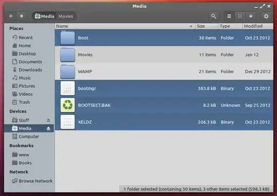

Selected Files/folders:
I don't know who these files belong to, but I'm afraid deleting them might cause something to break. How do I hide these files and folders so that they do not appear in Nautilus, but they are accessible by Windows, if they belong to it.
I have seen some guides where each file and folder to be hidden is prepended by a period (.), but that would change the file name, which may or may not break something.

These look like the relatively new Windows bootlader files. You're right that you shouldn't rename them, e.g. by inserting a dot before the name in order to hide them under Linux.
To hide otherwise in a GUI way, you can install Nautilus Actions Extra by first adding the repository using these terminal commands:
sudo add-apt-repository ppa:nae-team/ppa
sudo apt-get update
You can then install Nautilus Actions Extra using this command:
sudo apt-get install nautilus-actions-extra
You can install nautilus-hide only instead of the whole package using this terminal command:
sudo apt-get install nautilus-hide
Finally, you'll get (Un)Hide option in Nautilus context menu to hide any folder(s) and/or file(s) selected after restarting Nautilus with this terminal command:
nautilus -q
