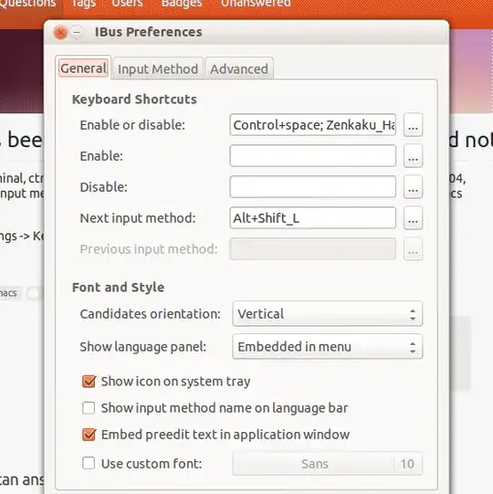

It sounds like you have Ibus running, which uses Ctrl + Space by default to enable/disable the input editor.
You can change the shortcut key assigned to it in Ibus Preferences.
If Ibus is running in the menubar, you can right-click to choose Preference from the menu. If Ibus is not running in the menubar, you can start the Preferences dialog from the Dash by running Keyboard Input Methods or from the terminal with ibus-setup.

After upgrade to ubuntu 14.04, I had the same problem. What I did.
In Ibus preferences: System > Preferences > Keyboard Input Methods.
There is an option: Next input method it was set to ctrl+space, I removed that and then all started to work back again.
