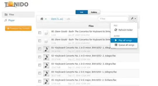

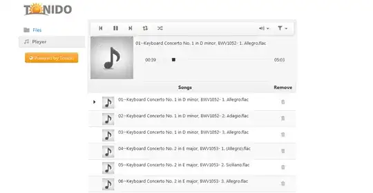

What about Tonido? It is not limited to the same network, is cross-platform, uses the internet browser to display shared files. Tonido has to be installed and running on the computer that shares the music. To share, create an account with an e-mail address, get a password and enter it when starting Tonido and when the internet browser opens.
Then you'll see your computer files and will be able to select the folders you want with a link.
Sending a link that shares an entire music collection would be the best idea. And then, saving that link (maybe as a desktop shortcut or as a bookmark in the internet browser) on the computer where you want to play the music.
You will be able to play the music in the Tonido's player. It can play MP3, AAC, OGG, FLAC, WMA, M4A, M4B, WAV (according to their page; more info there.)
