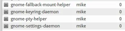

You get this warning because gnome services such as gnome-keyring-daemon and gnome-settings-daemon are not normally running when you are logged into a Xubuntu or Xfce session.
However, the quick fix that has worked for me is to go to the menu and choose settings > settings manager > session and startup > advanced and enable Gnome services (see screenshot below). Now, all installed Gnome services will start when you login, and you should be able to use the functionality of gnome-keyring-daemon (although further configuration may be necessary, as I note below).
It is important to note that you will have to logout and login again for this to take effect, and then services such as these will be running (if you have already have installed them with gnome applications):
You may need to tweak other things in the Xfce/Xubuntu session, depending on how you wish to use gnome-keyring-daemon. There are some references to using it with ssh on this blog and many others out there, but there can be problems to overcome with using it on Xubuntu.

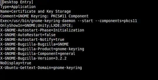

Another way to get rid of that pesky warning (I got this in XFCE):
The trick is to add "LXDE;XFCE;" on the line with OnlyShowIn= (without the double quotes and plus the semicolon, didn't try without it) to this file "/etc/xdg/autostart/gnome-keyring-pkcs11.desktop" by editing it with whatever text editor you prefer, I'll use "nano"
1 - in a terminal type (as root or with sudo):
# nano /etc/xdg/autostart/gnome-keyring-pkcs11.desktop
[Desktop Entry]
Type=Application
Name=Certificate and Key Storage
Comment=GNOME Keyring: PKCS#11 Component
Exec=/usr/bin/gnome-keyring-daemon --start --components=pkcs11
OnlyShowIn=GNOME;Unity;LXDE;XFCE;
X-GNOME-Autostart-Phase=Initialization
X-GNOME-AutoRestart=false
X-GNOME-Autostart-Notify=true
X-GNOME-Bugzilla-Bugzilla=GNOME
X-GNOME-Bugzilla-Product=gnome-keyring
X-GNOME-Bugzilla-Component=general
X-GNOME-Bugzilla-Version=3.2.2
NoDisplay=true
X-Ubuntu-Gettext-Domain=gnome-keyring
2 - after editing, make sure you save the changes
3 - restart computer.
