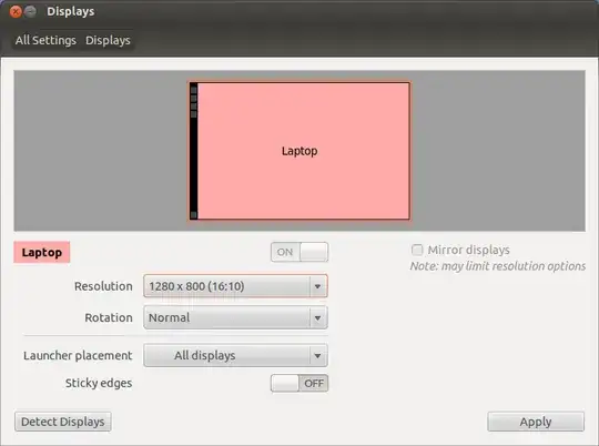

Go to System settings > Displays. You can change resolution in that. Something like this...
Displays
If System Settings doesn't do work, open Terminal (Ctrl + Alt + T). Run xrandr. Find what device has 1424×768 resolution (I call it name in command down). After that...
