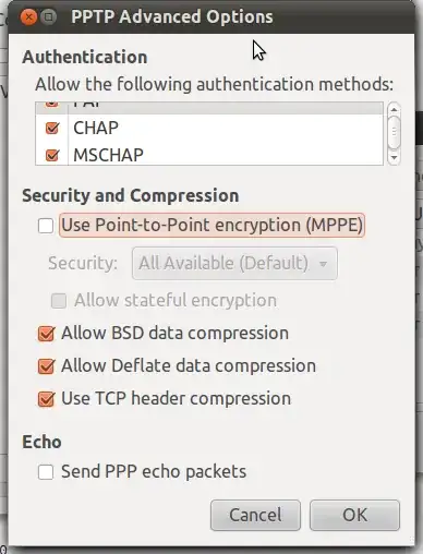

You may only be missing the actual encryption method, which seems to be specified in the
[Server&PPTP 2.8]
and
[Server&PPTP 2.8 Tunnel]
blocks from your example. This should roughly translate to the Advanced window in nm-applet's PPTP VPN configuration:
PPTP Advanced Options
I'd suggest first trying to enable MPPE and keeping all other options as default (so that it enabled MPPE, which offers encryption, and MSCHAP-type authentication methods, which are enabled in your example for the PPTP 2.8 section). If it doesn't work, disable all the authentication options but PAP, so that things would equate to about the same as the "PPTP 2.8 Tunnel" section in your example.
