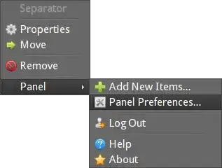

1) Just right-click the panel and go to panel preferences, as in the screenshot below:

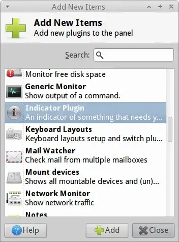

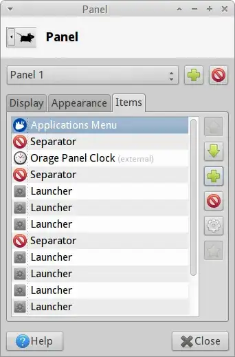

2) Then, just make sure the appropriate panel is selected, move to the items tab and click the green + in the items tab (not the one at the top of the screen) to add an item.
3) Now, scroll down the list and select the indicator-plugin, click add, and close the menus. Your volume control icon and mail icons will be restored.
