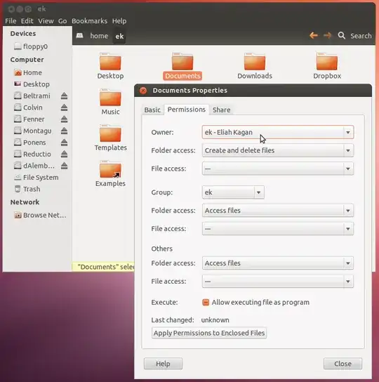

Changing Their Ownership (Recursively)
To change the ownership of a folder and everything in it, right-click on it in a root Nautilus window and click Properties. Go to the Permissions tab.
A nautilus Window, running as root, with a Properties dialog box up on a folder, showing how to change it's owner.
Change Owner to you. Click Apply Permissions to Enclosed Files (or it will only be applied to the folder, not the files and folders contained in it). Click Close.
Usually that's sufficient, and changing the permissions themselves is unnecessary. However, if you need to change the permissions, you can do that the same way (using the folder and file access drop-down menus under Owner, Group, and Others.
