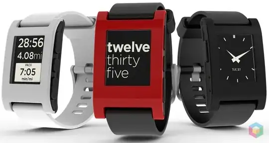

I want to have Conky display the time using words and not numbers.
What I want to do is more or less how the Pebble Watch looks (Red watch).
Like in the image, even if only the time and not the date can be shown.
Is this possible?

The script can do a boring option, which will translate 12:45 to "twelve forty-five", and an awesome option which will translate it to "a quarter to one". It also does a Uri Herrera option which does the hour bold ;)
