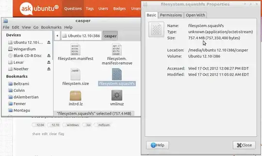

Almost all the data in the ISO image belongs to just one file, casper/filesystem.squashfs.
On an Ubuntu desktop CD or DVD ISO image, that is. On a server CD image or alternate CD image, it's a different story.
Nautilus properties for filesystem.squashfs on an Ubuntu 12.10 i386 desktop CD
So I can tell you right now what file is almost certainly corrupt on each of the ISO's you downloaded: that file, on all of them. When something is corrupted in an Ubuntu ISO, the bad bytes are almost always somewhere in there.
