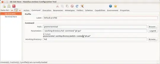

I'm using Nautilus Actions Configurator application to achieve this as shown below.
It does show the custom context menu, yet I would have expected it to also work this way, but it doesn't. Upon hitting my button it just opens Git GUI without actually run in the working directory of Nautilus is in.
What am I doing wrong about this current working directory?

You need to markup your working directory. This is how I would do it:
Path: /usr/bin/git
Parameters: gui
Working directory: %d/%b
This will use the current directory, then the basename of the directory selected.
