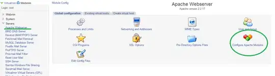

Webmin
addendum by the OP for future visitors
In Webmin, the basic steps about the Status module can be found here:
  • Servers -> Apache Webserver -> Configure Apache Modules
  • Select the Status module and click click Enable Selected Modules
